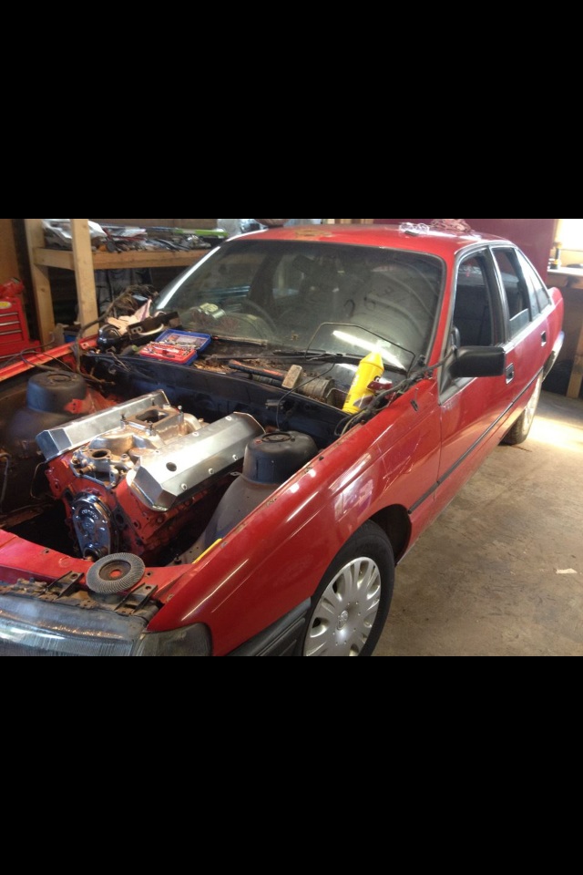

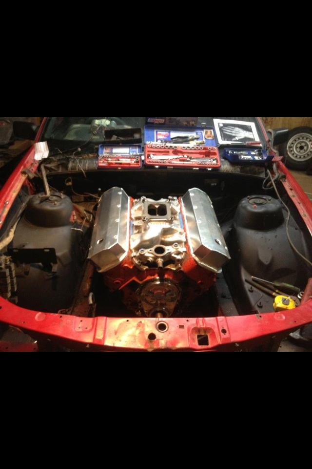

A mate and i have attempted this on a vn with a 468 bbc with success , hq mounts line straight up to v8 x member but rack fowles on sump so had to mod sump and pick up , also brake booster will need relocation a remote booster will do the trick then rest is pretty easy
