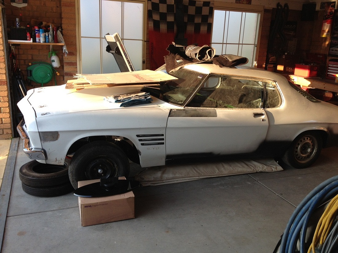

Well its been a while since an update
its also been a while since i did anything on the monaro
we had to pack it up as we recently moved out to cockatoo
pics are of the car back together full of sh*t for the move
seen better days but at least underneath is comeplete and brakes are all done

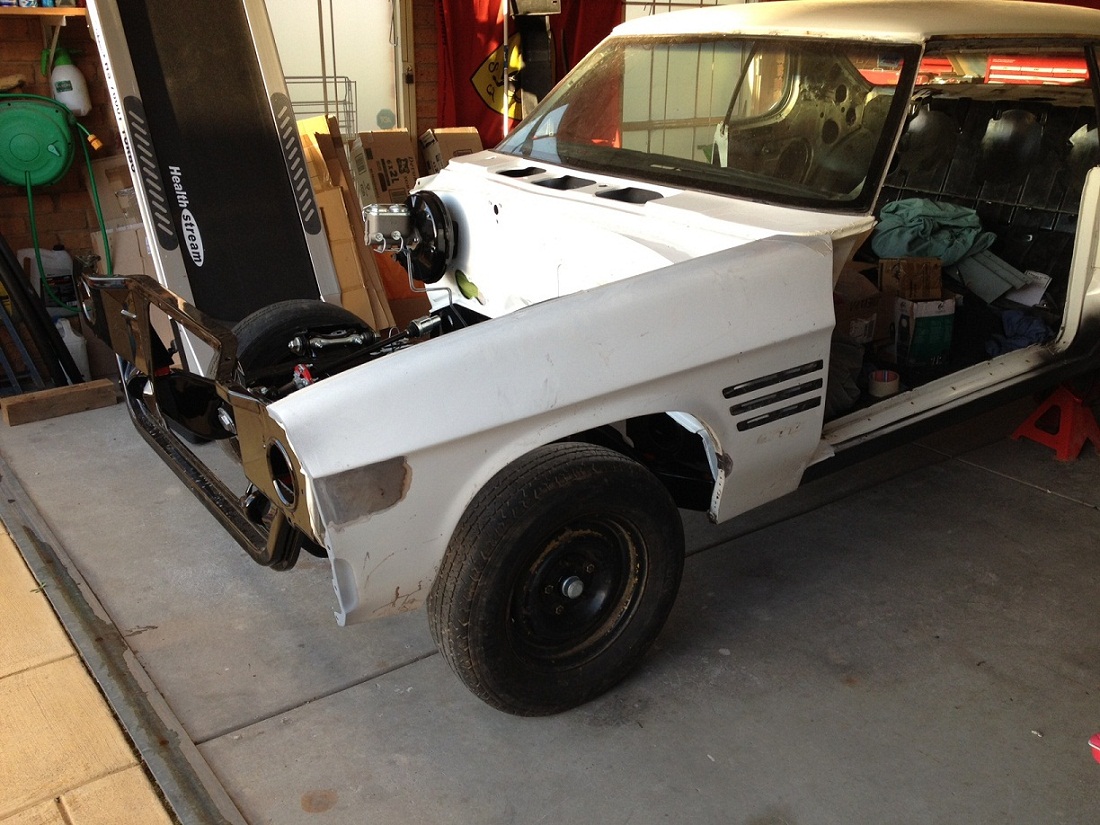

Now the monaro has a new home and its a lot bigger lol but full of crap at the moment
She has a new room mate
does it mean i will never go faster than the mower as it is red and red goes faster
LOL
