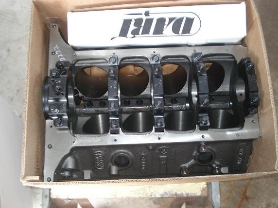

Dont waste your time with the heads mate set of dart pro 1 cost a few K's but would make it a completely different animal compared to those puppies.
you got the chance now dont waste cash on half assing it .
Nothing less then 400 cubes scat crank/rods hald decent cam nothing over the top in rockers plus pro 1 heads and you make 500-600 hp with out a problem all day long.
Thou a nice crate 502 would look nice.
Heres a tease of what l got a few weeks ago for the little rotary the build has started as well.
