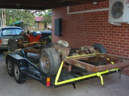

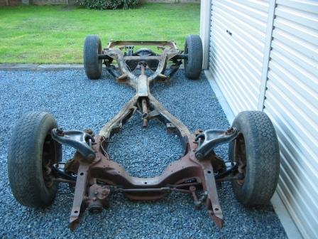

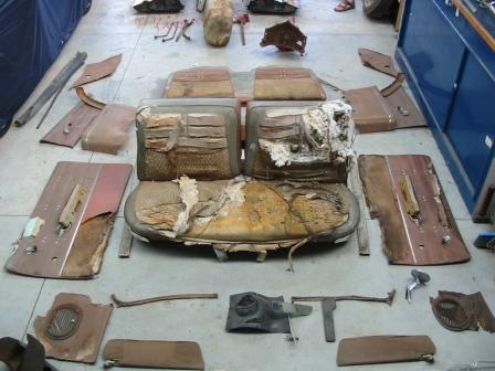

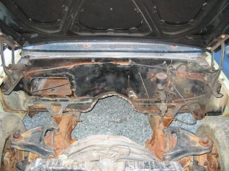

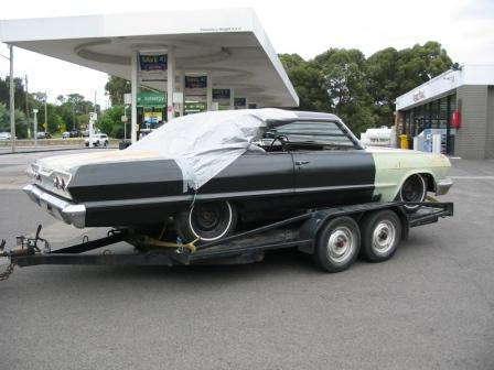

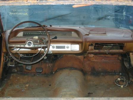

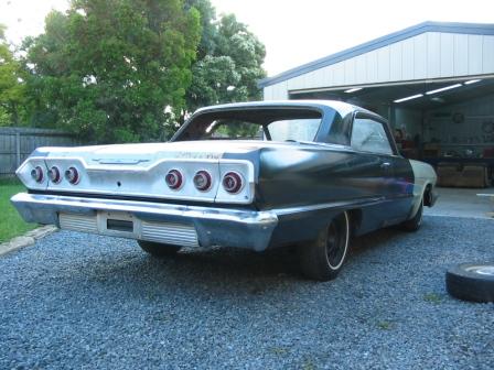

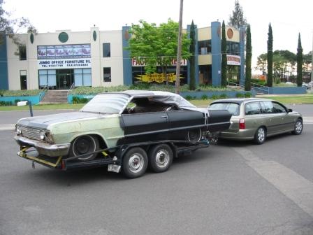

Well here is what we started with in November 2008.
I purchased the car sight unseen (except for a hand full of photos) off E-bay in Sydney. The deal was the body on one chassis, plus the drive line on another chassis, plus bits to make it a car...... apparently!
So i drove to Sydney (twice) and picked it all up! Here is what i got!
Some of my friends thought i was a little ambitious, i thought i was damn well mad!

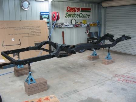

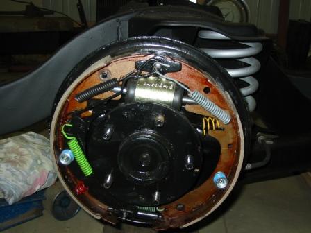

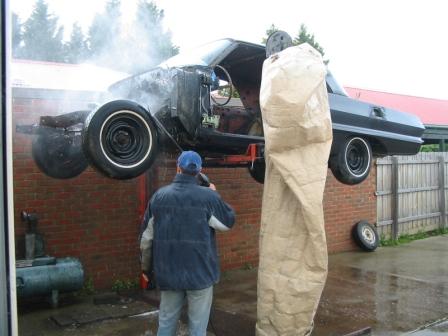

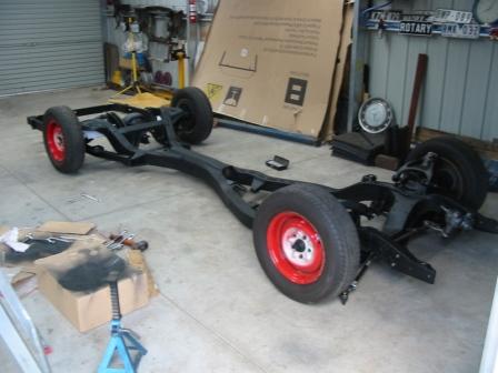

So once the car was home & i had been through all the stuff that i had, we stopped & made a plan!
The concept was - Build the rolling chassis, then add the drive line and put all this to one side. Then build the body on the spare chassis & mate the two together once this is done. After that finish it off.... easy, right?!?
So i removed all the hanging panels & took the car & gave it a good clean up (it was well dirty under there). Then we took the body off the good chassis & put it on the spare one. The chassis was then fully stripped & painted along with the diff & all suspension components. Then we reassembled the chassis with all new bushes, ball joints, tierods, pitman & idler arms & a reco steering box. While i was at it i recoed the rear drum brakes with new wheel cylinders, linings & a new spring and retainer kit. One rolling chassis to go!
